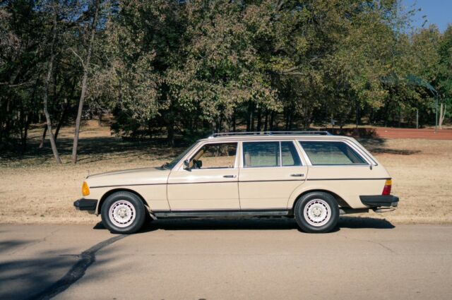

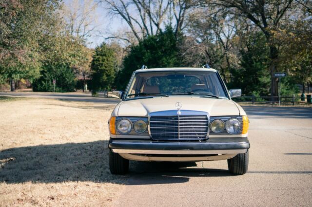

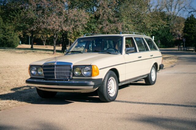

1985 S123 300TD turbo wagon from USA, OM617.952. Uncle Stavros left it to me and it came out of the container last week. Light Ivory over palomino, left hook, auntie took the pics before they loaded it.

Ben that spec was USA only mate, so dont chase Aust delivery parts books or youll go mad.

95 seconds idle / 48 seconds at 2,500 RPM before. 62 seconds idle / 34 seconds at 2,500 RPM after. Import papers say 623 Light Ivory too.. uncle had taste lol
