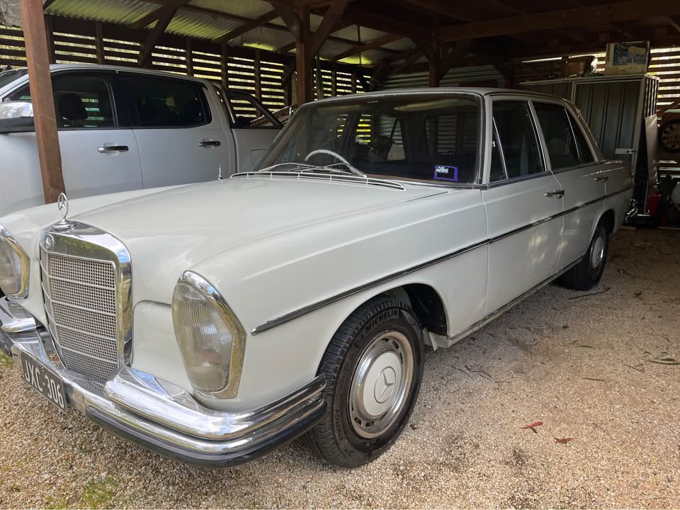

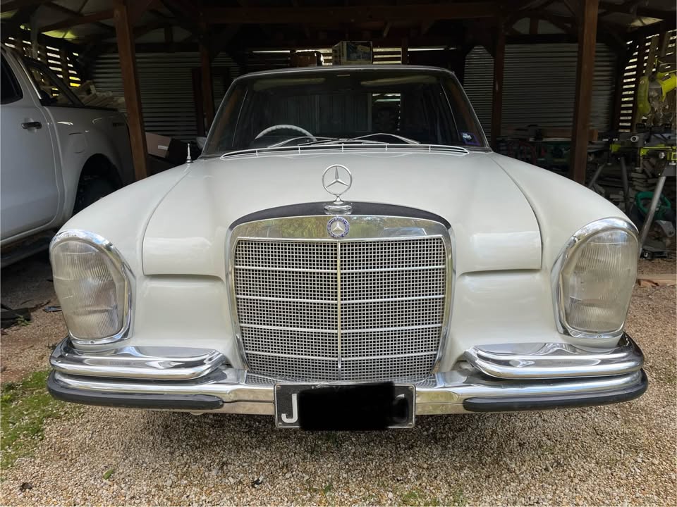

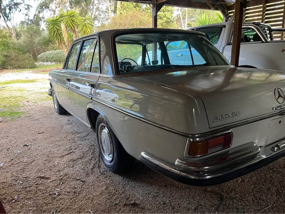

Hey boys, long time lurker first time poster.
Some of you know my uncle Steve - he gave me his '67 250SE last year when I came back from London during Covid. The car he bought new, shipped to England, drove thru the Baltics to Greece then back through London then shipped home. Proper world traveller car. He said "you take it now Vangeli, I'm getting too old to drive proper, kids these days they wreck them, you don't."
Boonie white 1967 W108 250SE 1Boonie white 1967 W108 250SE 2Boonie white 1967 W108 250SE 3Boonie white 1967 W108 250SE 4
First year I been mostly tinkering. Chrome hunting on ebay, replaced the boot rubber, fixed the dashboard clock. Lovely.

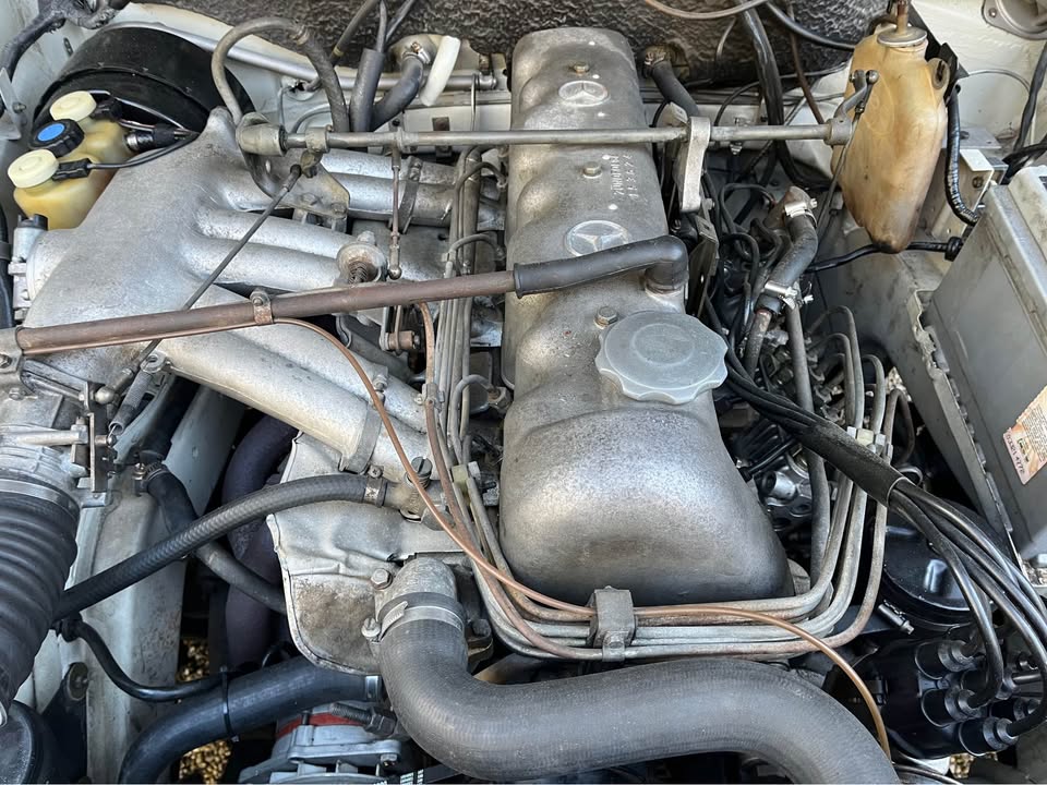

BUT - last 3 months she starts perfect, drives perfect, 15 mins in she just dies and theres a fuel smell. Like PROPER fuel smell. Tried it 4 times now same thing each time. Took it to my guy in Revesby, he said its the tank. CHANGED THE TANK. Same problem. Then said its the coil. CHANGED THE COIL. Drove fine for 2 months of weekend cruising Bondi Rd to La Perouse no dramas.
Then last tuesday on the M5 at 6am going to work she completely shat herself. Limped to the off ramp. He says its leaking fuel, changed the gauge $800 didnt even ask me first cheeky bastard.
I dont want to ring uncle Steve about this. He's in Folegandros for the summer and he's earned the rest. I cant let this guy in Revesby keep guessing on it though. The car has to be sorted by spring.
What would u boys do

Your mechanic is throwing parts. M129 doesnt usually fail from one magic thing. you have two problems overlapping.
15 minute stall + fuel smell is likely tank venting or rear rubber feed line behind LH rear wheel. also check fuel sender cork gasket, 110 471 01 80, about $12 at McStarparts. your bloke charging $1,400 for a tank he didnt need is painful.
Warm misfire / M5 dying.. check the coil. W108 wants Bosch RED 9V coil with the two ballast resistors. if he fitted Bosch BLUE 12V and left the ballasts, coil sees about 4V hot and spark gets weak. th is is exactly how they die warm.
Steve's car matters. 37,866 250SE sedans in 1967, and yours is half LHD loom / half Steve RHD conversion from 1968. Revesby mechanic reading a LHD diagram is guessing.
Pull coil, tell me colour. change nothing else.

Originally Posted by Vasilios_Billy
if your mechanic 'changed the coil,' did he change it for a Bosch RED 9V coil (correct) or a Bosch BLUE 12V coil (wrong)?
Billy you legend. It IS a BLUE coil. 12V coil on 9V wiring th is whole time. 2 months weekend cruising, points slowly dying, then dead on M5.. makes sense now.
I was filling it every drive too, just to be safe. probly making the sender leak worse.
Found Kosta via Mumma Jo's brother - Chris K's brother, Karpouzis Cafe in Campbelltown. he pulled the seat, said gasket. my mate Kosta did it $300 cash Saturday. red 9V coil next weekend.
VIKTOR mate im not selling it. its my uncles car. heat shield tip noted.
How do i know if rear feed line is perished too. still tiny fuel smell warm.

Rear fuel feed line: jack it safely, look behind LH rear axle where rubber line exits body to pump area. after 50+ years it goes hard. twist it, if micro cracks show, replace. Cohline 5x10, metre or two from McStarparts or GMS Spares Revesby. proper fuel clamps, not Bunnings worm-drive rubbish.
While under there, check in-tank pickup screen. if it was pulling vacuum with sender gasket leaking, screen can crush and cause starvation.
Red 9V coil goes in, then verify both ballast resistors on LH inner guard, white ceramic, two of them, each about 0.9 ohm. if one is bridged youll cook the coil again.
