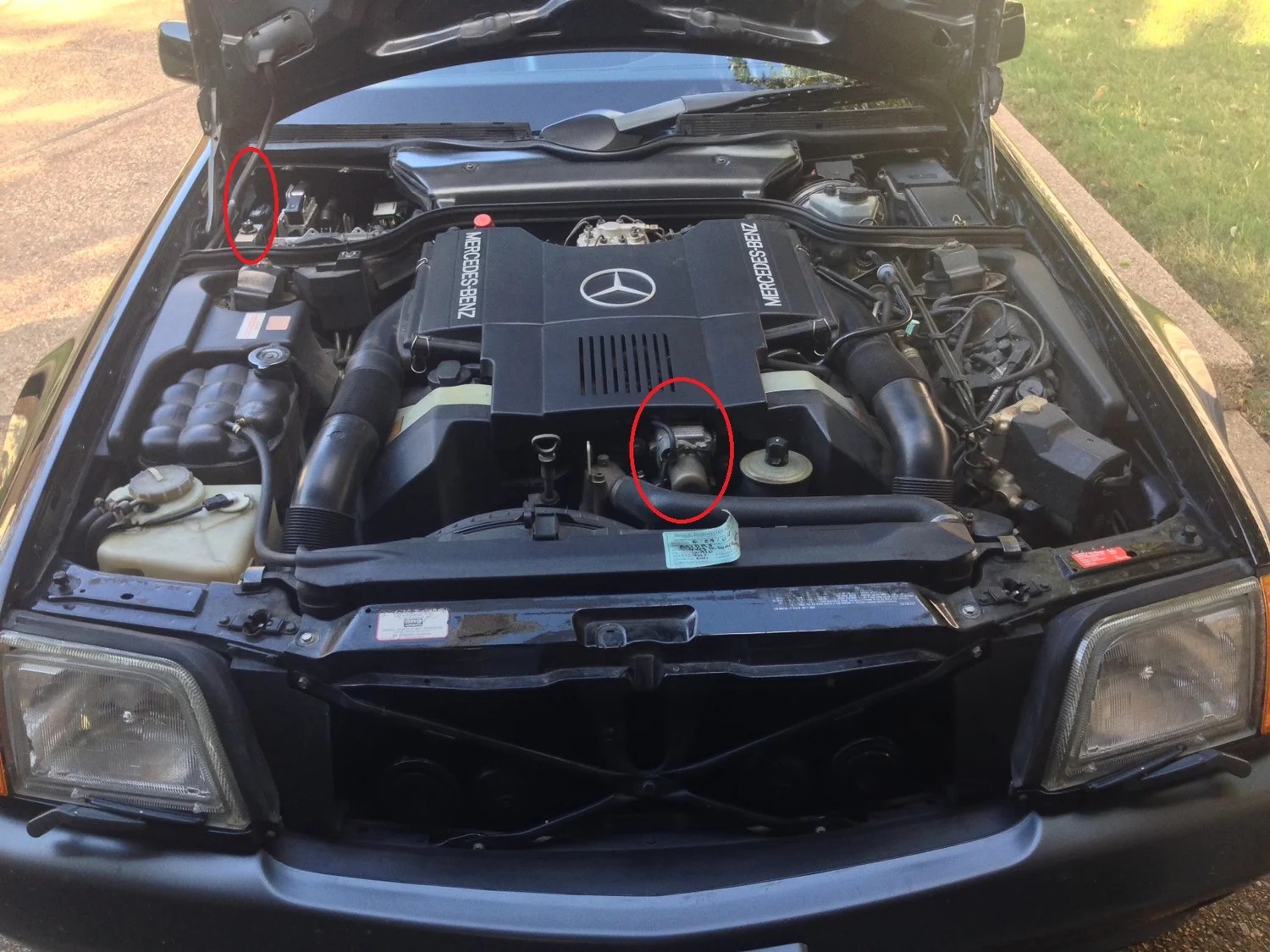

1985 500SEC. Cruise has been intermittent for 6 months and last week died completely. Diagnosed by elimination as the cruise control card (the electronic control module, MB part A 116 584 00 26).
W126 cruise control amplifier location under the dash

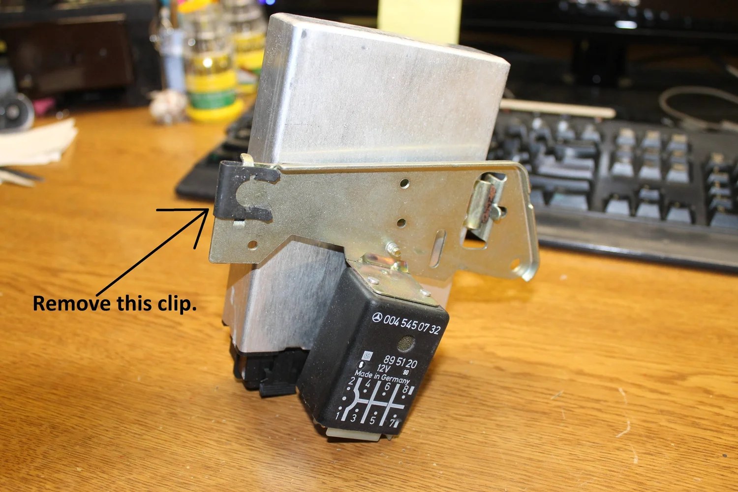

W126 cruise control amplifier mounting bracket
W126 cruise control amplifier module reference
